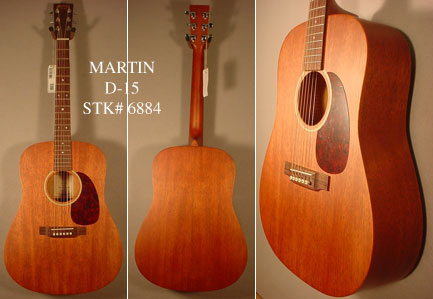

Are you planning on binding the body or just hiding the edges together? I don't know if you've seen the low end martins all mahogany, they arn't bound and I think they look plane, boring and cheap.

I'm curious as to what got you interesting in trying a mahogany topped guitar?
The only ones I ever played where the low end Martins and I didn't like them much. I'm sure that you could get a better sound than those Martins.

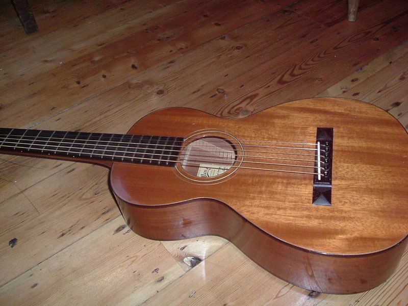

I made an all Cuban Mahogany parlour guitar as a copy of a turn of the century American guitar I have, but using X bracing rather than the ladder bracing of the original. I didn't really do anything that differently from when I was working with a spruce topped guitar in terms of thicknessing and bracing. I tend to have my tops about 3mm thick in the centre, and thinning out at the edges and in the lower bout behind the bridge. Here's a pic of the guitar and the bracing:
I think mahogany topped guitars have an undeserved bad reputation. The guitar had great sustain, balance and projection and that growl you associate with early 20's and 30's blues.
PostPosted: Fri Jan 06, 2006 11:21 pm
WOW! Beautiful guitar and bracing right to the end of the lower bout Dave! That growl you mention, could it be a combination of stifness, type of wood, the bracing or the way your bracing is made at upper bout, directing in a V?

PostPosted: Sat Jan 07, 2006 12:50 am
Serge,
I think it is a combination of the guitar size/shape, and the Mahogany. the original has the same growl but with 80+ years more maturity (excuse the feet in the photo!!!):
Martin Simpson played the old guitar and said that the only think missing to make it sound like Blind Willie Johnson was the "scratch, scratch, scratch . ." sound from the old 78rpm recordings. He thinks that these sort of guitars were used a lot by the early greats as they were very cheap and were "played to death". Martin played his repetoire of slide blues/gospel on the guitar for an hour or so and let us video the performance - awesome. The proof that most of the "digital enhancement" lies in the player's fingers as well as the guitar comes home to me every time I try and play the same things after watching the video
I also suspect that a lot of these early guitars and early Martin's used Cuban mahogany as it was pretty readily available then.
PostPosted: Sat Jan 07, 2006 1:58 am
Dave your little parlor bracing is inspirational. Very well done, and quite original looking. Even the bridgeplate is oriented the way Mario mentioned the other day.
Then to top it off you share the photos of the old mahogany parlor. That's an incredible looking instrument. Wish we could all see the Martin Simpson video with you. Thanks.
